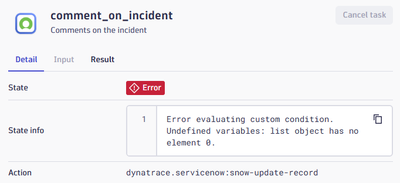

I've created a workflow for Dynatrace-Service Now integration.
On this step, it returns this error:

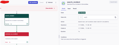

But the previous step has State "Success"

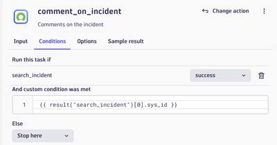

The condition of the step that is failing is this:
Does anyone know why it's failing in spite of the previous step is returning Success and how to fix this?

Probably the search_incident step has State: Success but State info: null - meaning the search executed successfully but found no incidents (returned an empty result).
However, your comment_on_incident step's custom condition is trying to access:
{{ result("search_incident")[0].sys_id }}
This fails because there's no element at index [0] in an empty/null result, causing the error: "list object has no element 0"
You need to check if the search actually returned results before accessing the first element.
try to modify the custom condition to:
{{ result("search_incident") and len(result("search_incident")) > 0 and result("search_incident")[0].sys_id }}

You're right. The State info is null. That's because it doesn´t find any incidents.

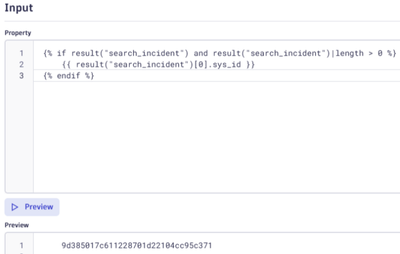

But this:
{% if result("search_incident") and result("search_incident")|length > 0 %}
{% endif %}
returns results onces there is created incidents:

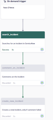

I've run again the workflow and now the workflow ends successfully but it skips the two next steps:
I think it’s working properly now and this behaviour it's normal. And if it's skipping the next following steps and doesn’t do anything else, I think it’s because the created incident hasn´t been any changes so far. And as no further issues have been creating in Problems, there’s nothing new for it to create either.
{% endif %}
You're right, my solution included python intead of jinja 😄
So now, the behavior is working as intended:
 No incident found → Custom condition evaluates to false/empty
 "Run this task if" condition fails → Step is skipped
 Subsequent steps that depend on this one → Also skipped (cascading skip)
