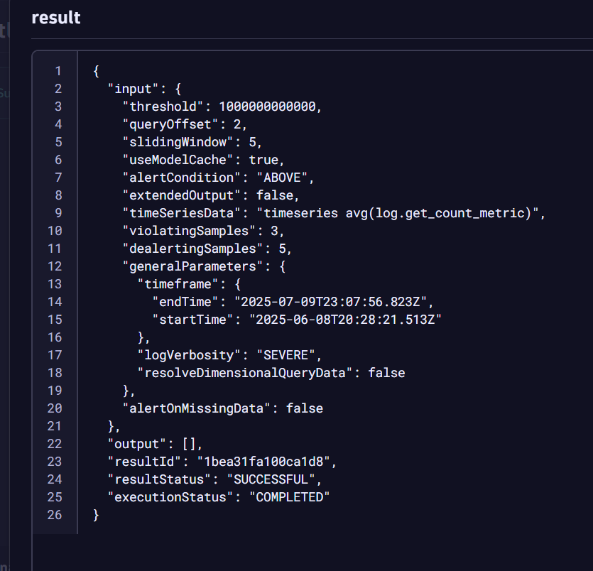

Yes, you need to push the problem using a separate task. For instance, I have two executions—one without anomalies and another where the static threshold condition was exceeded.
Use values from the result JSON to define a condition in the next task. Based on that, I either send an alert to Slack or push a problem to the Problems API.
You’ll notice that the execution with an issue includes additional fields like raisedAlerts, numberOfViolations, etc., which help identify and handle the problem.
