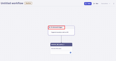

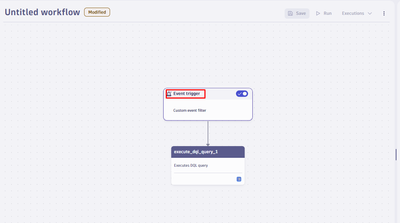

Hello,
If you want to know what type of trigger the workflow is using, it is shown in the label on the first tile.
If you set an event trigger, you still have the option to manually trigger an execution by hitting "Run" at the top.
