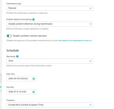

Maintenance window is already configured but not serving the need.

Can you share maintenace window created?

Sure -
Problem Statement: The auto scaled hosts are coming for somewhat ex 5mins and by that time the tags are not getting propagated. Once it is getting propagated its too late the hosts are already gone.
As a reason both the MW umbrella and problems are seen on the last given snap.

Important thing is scope. Are those hosts in scope? Are you filtering them by tag or management zone?

With "tag" and yes "hosts"!
MW is perfect! The 1st snap has the umbrella.

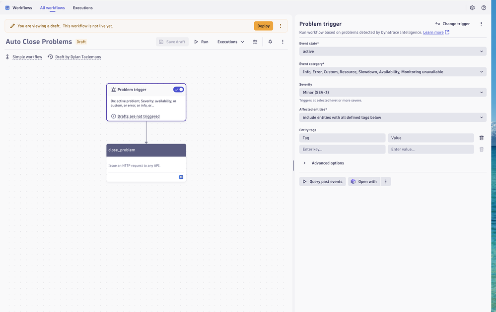

Hey,

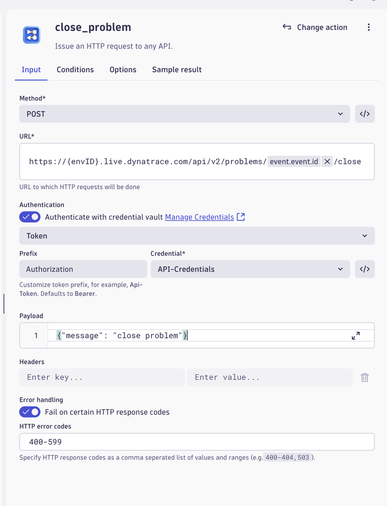

You could use the Problems API to automatically close the issue.
It is strange that the maintenance window is not working, as this should normally prevent the problem from being created in the first place avoiding pollution of your env.
Using a workflow is more of a workaround / dirty fix rather than the ideal solution.
Note: Instead of using tags, you could leverage the advanced options to create more detailed and granular filters. However, this should already provide you with a good first version to get started.
Replace {envID} by your envID.
https://{environmentid}.live.dynatrace.com/api/v2/problems/{{event()["event.id"] }}/close

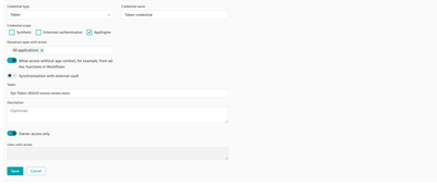

in your credential vault don't forget to add 'Api-Token ' before copy pasting of your token
