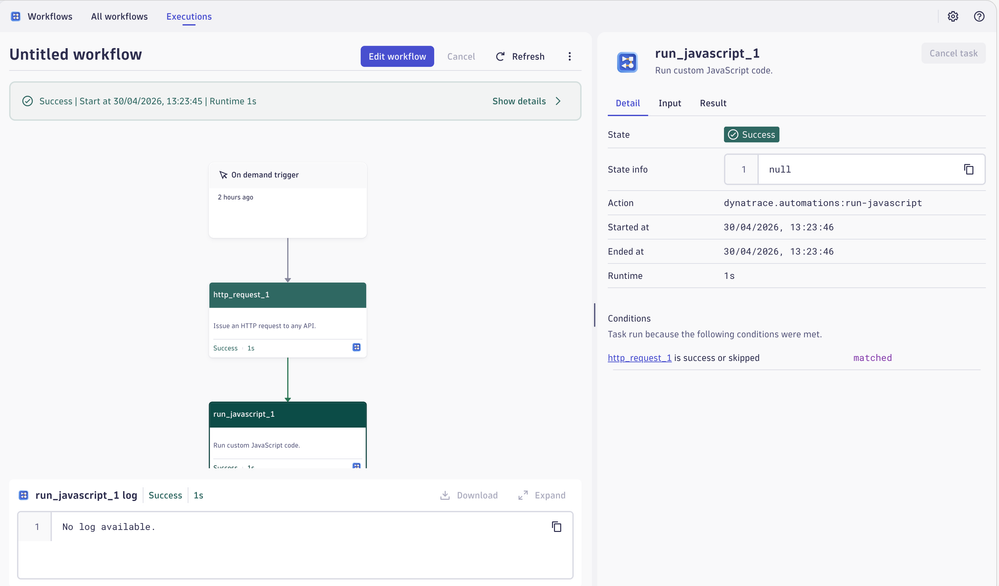

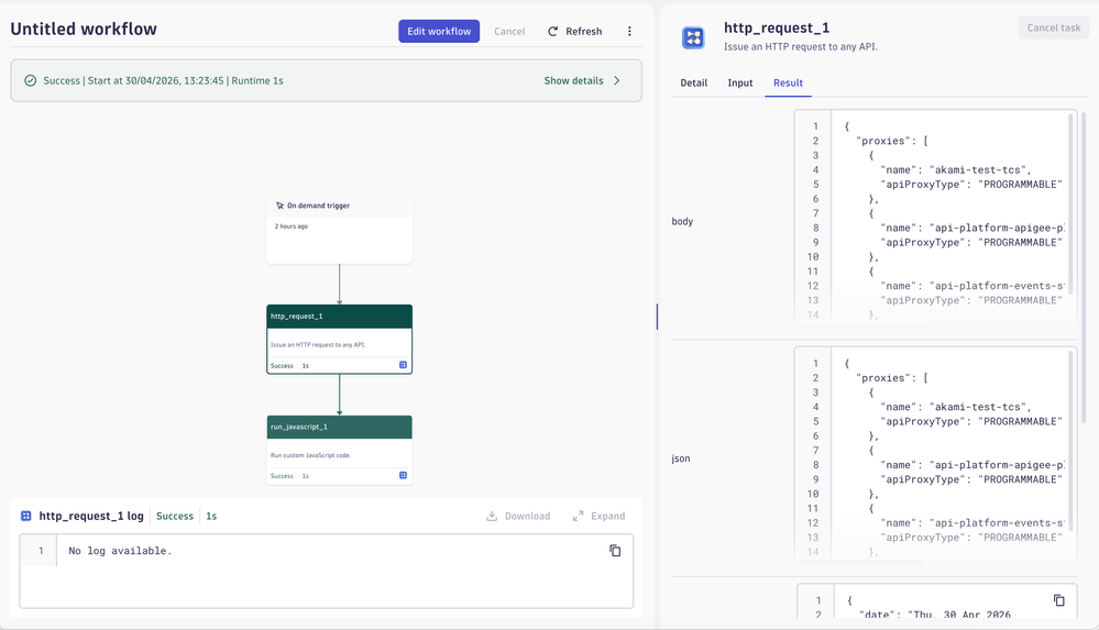

Thanks for the detailed explanation @MaximilianoML — I followed the steps you outlined (HTTP Request → Run JavaScript → Ingest BizEvents). The workflow executes successfully till javascript action, but in the Run JavaScript step I’m seeing “No logs available” in the execution details also in the http request i am able to generate json data but there also seeing "No logs available"
Does this indicate that my JavaScript step isn’t returning the normalized objects correctly, or is it expected behavior when no explicit console.log is used? I want to confirm whether the BizEvents are actually being passed downstream to the ingestion step, or if I need to adjust the way I’m returning the array.
Could you clarify how to verify that the BizEvents are being generated and ingested into Grail, especially when the workflow UI shows “No logs available”?
Thanks again for your guidance — I just want to make sure the ingestion pipeline is working end-to-end.

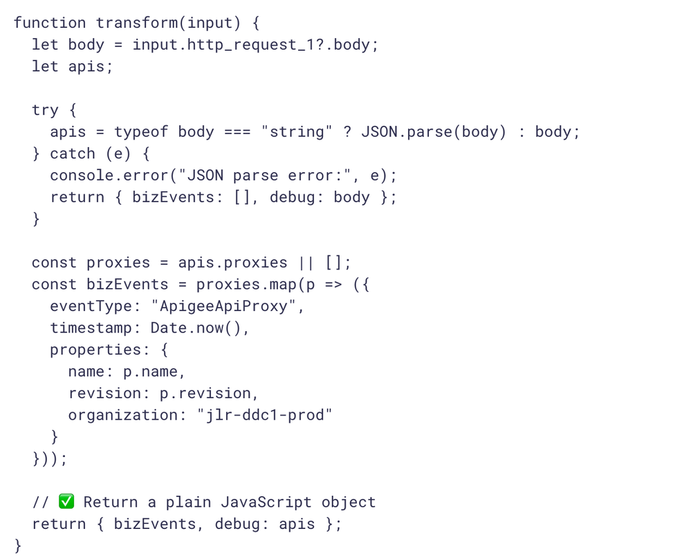

Screenshot 2026-04-30 at 3.35.19 PM.pngScreenshot 2026-04-30 at 3.35.58 PM.pngScreenshot 2026-04-30 at 3.36.41 PM.png
I have attached the image of the workflow and the script I have used and showing "No logs available".
Can u help me with the same @MaximilianoML

No logs available in the Workflow execution details does not automatically mean that the JavaScript action failed or that nothing was returned.
In this case, it usually only means that the action did not write anything to the log output, for example with:
console.log(something)
console.error(error_something)
The important thing to check is the Result of the JavaScript task, not only the Logs tab. Dynatrace’s Run JavaScript action can return a custom object or array, and that returned value is available to subsequent workflow tasks. The result can be inspected in the execution details and used by later tasks.
Looking at your JavaScript, the main point is that you are currently returning this structure:
return { bizEvents, debug: apis };
So your JavaScript result is not the BizEvent array itself. It is an object that contains the array under the bizEvents property.
That means, in the Ingest BizEvents step, you should either reference only that nested array, something like this:
{{ result("run_javascript_task_name").bizEvents | to_json }}
 Personally, I would simplify the JavaScript and return the array directly:
function transform(input) {
  let body = input.http_request_1?.body;
  let apis;
  try {
    apis = typeof body === "string" ? JSON.parse(body) : body;
  } catch (e) {
    console.error("JSON parse error:", e);
    return [];
  const proxies = apis?.proxies || [];
  const bizEvents = proxies.map(p => ({
    "event.type": "apigee.proxy.metadata",
    "event.provider": "apigee",
    "event.category": "api-management",
    "source.system": "apigee",
    "apigee.organization": "jlr-ddc1-prod",
    "proxy.name": p.name,
    "proxy.revision": String(p.revision ?? ""),
    "debug.ingestion_test_id": "apigee-test-001"
  console.log("Generated BizEvent count:", bizEvents.length);
  console.log("First BizEvent:", JSON.stringify(bizEvents[0] ?? {}, null, 2));
  return bizEvents;
Also, I would recommend using Dynatrace way to event fields such as:
Let me know if worked and the next step, please 😉
