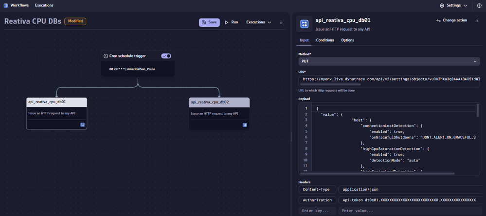

Hi team, good day.
The idea is to create a Workflow to disable CPU monitoring for some hosts in a crontab way (we do downsize some machines for $aving purpose) to avoid unneeded alerts/problems, since the Maintenance Window does not allow us to suppres a specific event type, yet.
I know I can call a Workflow in a crontab way, what I don't know is how to properly call the api/v2/settings/objects API as a task. I was expecting something we have for ingest data, for example.
Any clue/help on this?
Thanks.

Thanks, @rkdy , it was really helpful.
That's the final javascript code for the purpose I need, to disable the CPU monitoring for a specific host only:

08 Nov 2023 05:41 PM
I completely missed the native option that runs http requests into workflow ![]()
Javascript code is required to run batch executions, but in my case, it was simple run in two hosts only.
Anyway, I learned, and I am happy. 😅
