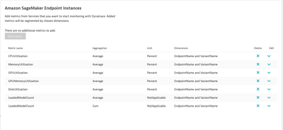

We recently added and enabled Amazon SageMaker cloud metrics on one of our ActiveGates.
Dynatrace successfully created all of the metrics we enabled, as they are visible in the Metrics app.
However, none of them are showing any data points, even after we confirmed there is data visible in the Amazon SageMaker console and in CloudWatch.
