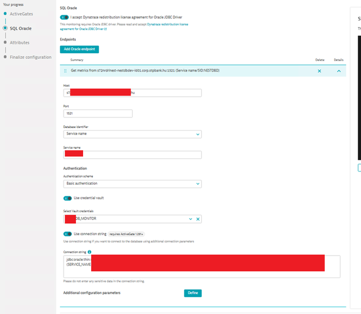

Hi @VFVCLIV,
Check the extesnion documentation and configuration and you will see it is possible. As @dannemca mentioned your environment ActiveGate should have access to the Oracle database service port in my case on the default 1521. So you should solve the network access, and then a proper oracle user will be required (based on the documentation.
