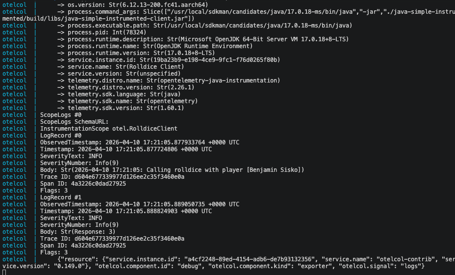

The problem with sending telemetry to the Collector via the debug exporter is that you get a text output like this:
This type of text-based output makes troubleshooting challenging, especially if you’re used to having some nice IDE extensions to help with troubleshooting. Wouldn’t it be nice to have a local tool for visualizing OpenTelemetry signals?

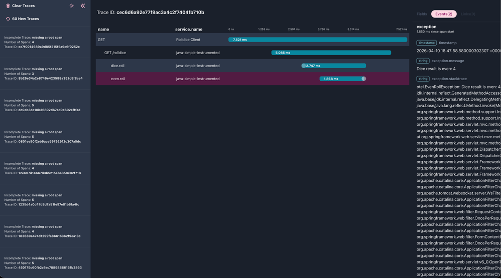

OTel Desktop Viewer
The OTel Desktop Viewer is a desktop tool for viewing OpenTelemetry traces. The project started in October 2022.

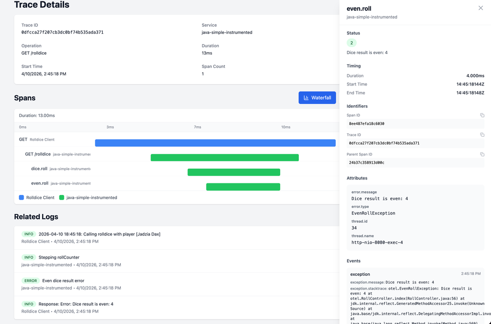

Below is a sample trace output from OTel Desktop Viewer:
Clicking on a span reveals various span attributes and span events (if applicable).

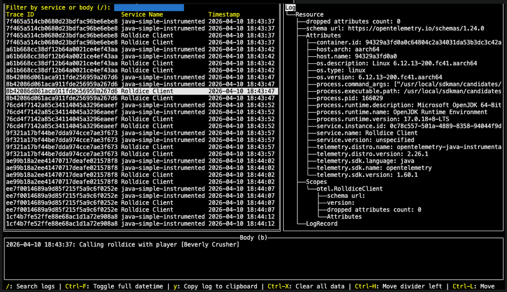

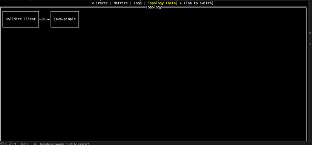

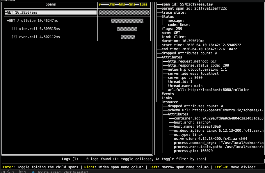

otel-tui
otel-tui is a terminal OpenTelemetry viewer inspired by OTel Desktop Viewer. The project started in March 2024.
Below is the docker-compose.yaml to run the Collector and otel-tui:

Next, add an OTLP HTTP exporter for otel-tui to your Collector config.yaml, where otel-tui is the name of the otel-tui’s docker container.
exporters:
  debug:
    verbosity: detailed
  otlphttp/otel-tui:
    endpoint: http://otel-tui:4318
receivers:
  otlp:
    protocols:
      grpc:
        endpoint: 0.0.0.0:4317
      http:
        endpoint: 0.0.0.0:4318
connectors:
  spanmetrics:
service:
  pipelines:
    traces:
      receivers: [otlp]
      exporters: [debug, spanmetrics, otlphttp/otel-tui]
    metrics:
      receivers: [otlp, spanmetrics]
      exporters: [debug, otlphttp/otel-tui]
    logs:
      receivers: [otlp]
Unlike the OTel Desktop Viewer, otel-tui supports traces, logs, and metrics. It also has a Topology view, which shows the relationship between OpenTelemetry services. The UI looks like a graphical command-line tool and relies on the keyboard for navigation.
Navigation:
  • Use tab to navigate between traces, logs, and metrics views
  • Use up and down arrow keys within each view to look at specific telemetry
  • Use d to view details about a trace, log, or metric, in the respective view.
Traces view:
Logs view:

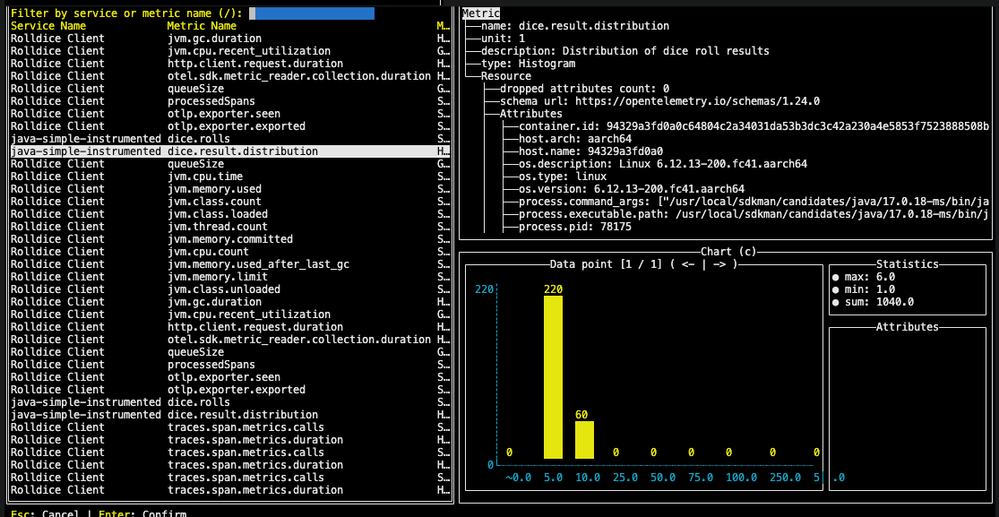

Metrics view:
Topology view:

Below is the traces view. It shows related logs, span events, and span attributes:

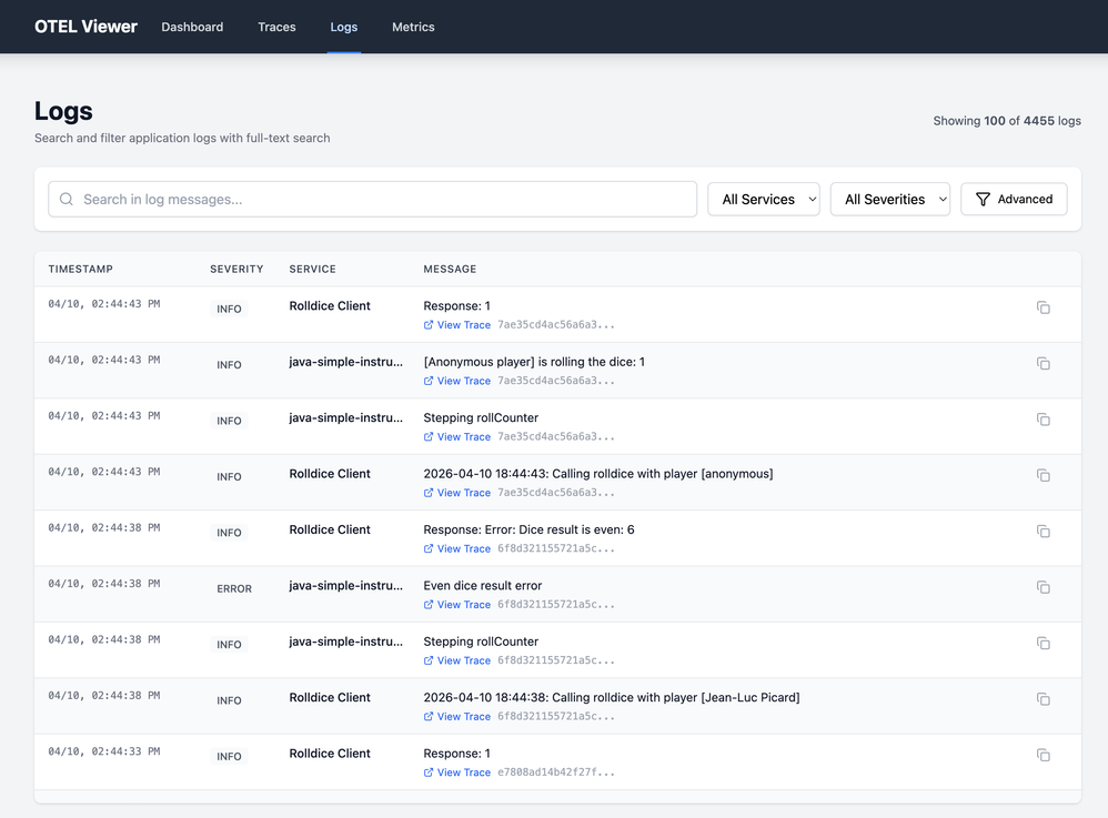

Below is the logs view:

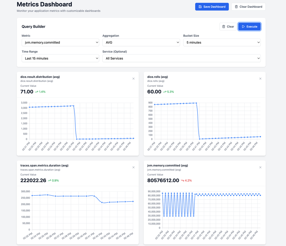

Below is the metrics view:

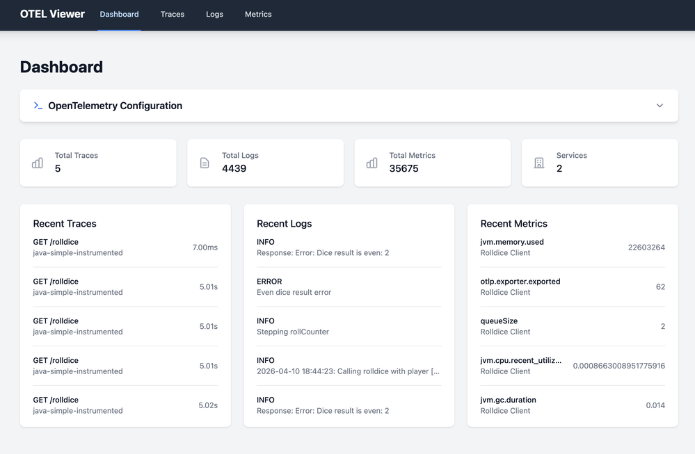

It also has a dashboard view:
Unfortunately, the dashboard is not clickable, meaning that you can’t click on, say, a recent trace to take you to the traces view.
