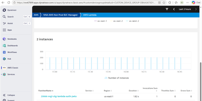

Hi Team,
I'm trying to instrument an AWS image-based Lambda with Dynatrace by adding the following components through the AWS CLI:
  • Dynatrace Lambda extension
  • Dynatrace layer
  • Dynatrace agent configuration
The deployment completes successfully, and the Lambda executes without errors.
Current Behavior
  • ✅ Lambda invocations are successful.
  • ✅ CloudWatch logs are being generated.
  • ✅ The Lambda is visible in the Dynatrace managed account/environment.
  • ✅ Environment variables appear to be configured correctly.
  • ❌ No traces are being generated.
  • ❌ The Lambda is not appearing under Services in Dynatrace.
  • ❌ No end-to-end distributed tracing is visible.
