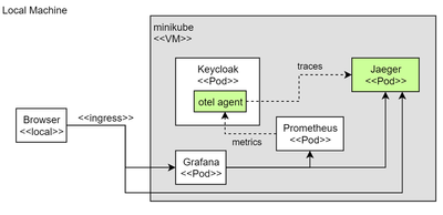

Can we assume that Dynatrace can replace Prometheus and Jaeger to receive the metrics dan traces via Otel agent?
https://www.keycloak.org/keycloak-benchmark/kubernetes-guide/latest/util/otel

As per the keycloak doc, looks like they are not using common OpenTelemetry way to export metrics.
My suggestion is to use the prometheus datasource https://docs.dynatrace.com/docs/extend-dynatrace/extensions20/data-sources/prometheus-extensions

How about the traces, can we replace Jaeger with Dynatrace?

Looks like they have a specific configuration to send only to jaeger. You should try installing the oneagent..

Is it better than Ingesting data from Jaeger into Dynatrace?

To catch from Jaeger you need an additional collector.
If you can catch directly from the agent you save additional configurations.
