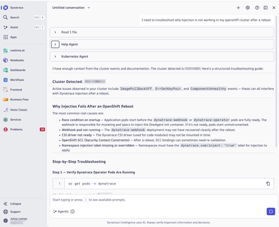

Nowadays, top AI models will give you very good recommendation, but - why not ask Dynatrace intelligence in the first place? Be sure to have agentic mode enabled. It will give you much better answers.
