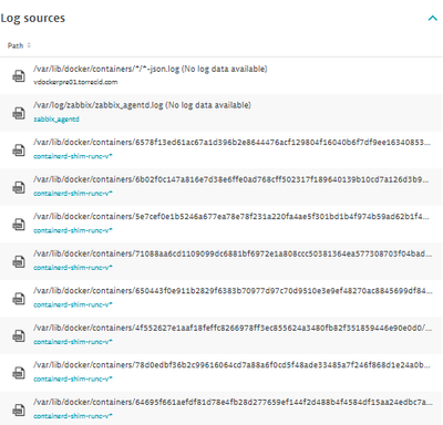

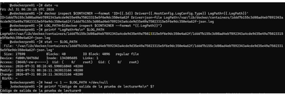

I've created a custom log source with the following path: /var/lib/docker/containers/*/*-json.log. I know there are logs inside the containers at that path:
but I'm getting the same result as with the auto-discovered log sources: “no log data available.”
