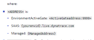

Hi @Nickolay
You will need to login with the follows:
Taken from documentation regrading Container build-time injection (step 1&2)
HTH
Yos
30 Mar 2021 08:47 AM
Many Thanks, it`s solved the problem!
