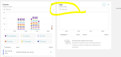

I seem to see metrics et al, excepts logs of my pods.
cf below to show that the stuff seems to run alright
I understand that for application instrumentation, I need to redeploy the pods.. which I did
As I said dynatrace seems to give the metrics fine and even the smartscape topology is building up nicely.. but I am desperate to see the logs produced by pods or from instrumented java applications.

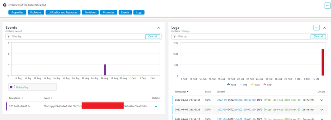

I have just set up a logging for a springboot app in an onprem OP cluster. It works fine. Application log can be seen.

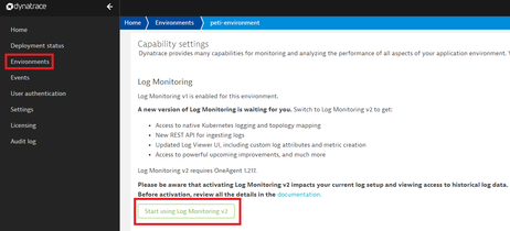

2. Log monitoring v2 should be switched on.

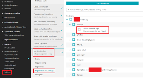

3. Process or host level log source configuration (example):
Log monitoring documentation:
