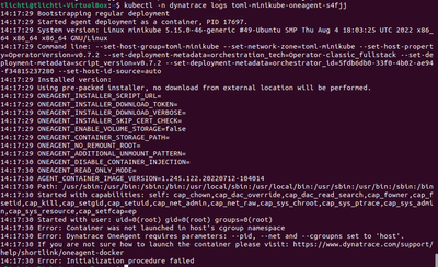

I am trying to work through the DTU Kubernetes lab, and I am stuck on what feels like the last step. The OneAgent pod will not start, the log is ending with the following:
00:49:55 Started with user: uid=0(root) gid=0(root) groups=0(root)
00:49:55 Error: Container was not launched in host's cgroup namespace
00:49:55 Error: Dynatrace OneAgent requires parameters: --pid, --net and --cgroupns set to 'host'.
00:49:55 If you are not sure how to launch the container please visit: https://www.dynatrace.com/support/help/shortlink/oneagent-docker
00:49:55 Error: Initialization procedure failed
I have googled every error message, combed through yaml files, and I have not been able to figure out if this is the real issue, or something else? I've tried adding the 'useUnprivilegedMode: true' setting in the dynakube.yaml, but it didn't make a difference. I'm fairly new to deploying Dynatrace in K8S, not new to Dynatrace though, this one has me stumped!

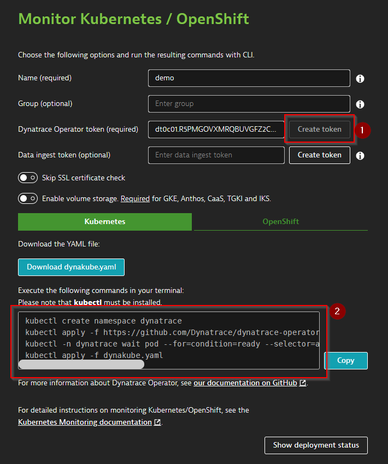

I used the automated Dynatrace Operator guide here: Get started with Kubernetes/OpenShift monitoring | Dynatrace Docs

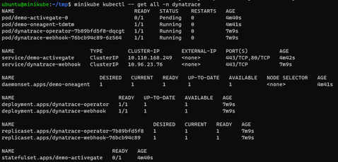

Hi @TomLichti,
I tried to reproduce it, but didn't have these problems. The OneAgent pod was able to start.
My setup looks like this:
It was a new VM only minikube and docker were installed according to instructions.

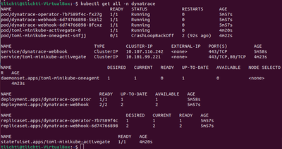

I just re-did the whole thing from scratch and I get the same error again:
The only difference I can see is that I used Ubuntu 22.04. I guess the last thing to try would be to use 20.04 as that is literally the only thing that is different. I would appreciate if anyone else who has used Ubuntu 22.04 and Dynatrace K8S via the Operator would chime in to see if it's just me.
17 Aug 2022 05:05 PM
I built a new VM on Ubunto server 20.04 with microk8s and it works. So it seems like there is something either with 22.04 or 22.04 Desktop that it didn't like.

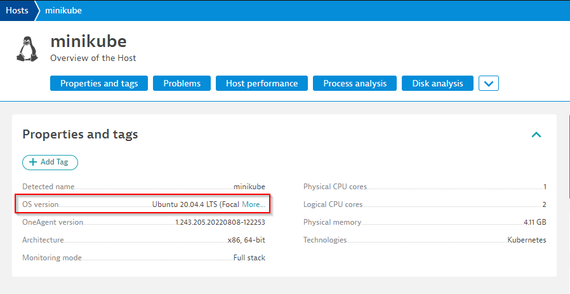

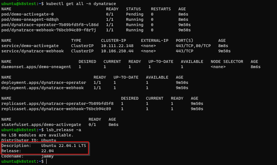

Hi @TomLichti, @techean
I also tried it with Ubuntu 22.04. It works. My ActiveGate doesn't run because I do not have enough CPU 😇. But the agent works. However, I am surprised that the agent shows me Ubuntu 20.04 as OS, but it was set up in VM 22.04.
I don't know what the difference is to your attempts. But as I said, the detection of the OS also makes me wonder 🤔.

@andre_f I followed the exact same steps, but for some reason, my AG pod doesn't get created/doesn't start up - any idea why that would be? I've tried it using EC2 instances as well as local VMs. Do I need to change anything in the dynakube.yaml file, or use it as is from the deployment screen?
18 Aug 2022 02:04 PM
I used the default dynakube.yaml file and didn't customize anything. Did you try a "describe" to see what the problem might be?
kubectl describe pod/<AG-POD-NAME> -n dynatrace
18 Aug 2022 03:20 PM
If I run "kubectl get all -n dynatrace" the AG pod doesn't show up at all, so "describe" won't work, as I need the pod name, right?
18 Aug 2022 03:31 PM
Ah okay. Sorry about that. I thought that the pod was there but would not come into the status "running".

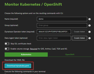

If you download the dynakube.yaml here (see screenshot), you should not need to adjust anything.
This part is already included there (I have removed some comments here):
# Configuration for ActiveGate instances.
activeGate:
# Enables listed ActiveGate capabilities
capabilities:
- routing
- kubernetes-monitoring
resources:
requests:
cpu: 500m
memory: 512Mi
limits:
cpu: 1000m
memory: 1.5Gi
