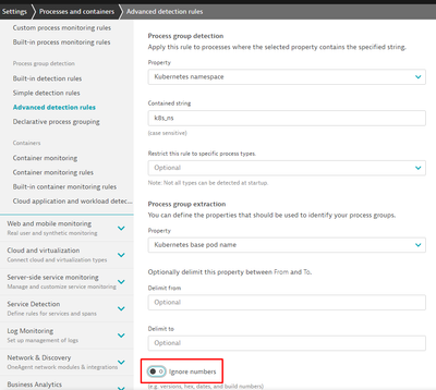

Hi @Yosi_Neuman
You should create an Advanced detection rule for the Process Groups based on k8s. Be sure to do not ignore the numbers because those are the versions are you expecting to split.
Example:
Note: After creating this rule, you need to restart/killing the pods and wait to recreate new ones and the new PG rules applies.

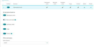

first of all - what deployment model in Kubernetes are you using? The answer pretty much depends on that. If you use cloudNativeFullStack or applicationOnly, you can use the build label propagation feature. It will set DT_RELEASE* environment variables based on the metadata of the workload.
If you use classicFullStack, this does not have any effect, but you can set the variables also manually in the application deployment (one of our customers preferred this way and stayed with classicFullStack for now). Don't forget to set a rule in the cloud application and workload detection, for example:
If all this fails, you can use also old school methods of defining your own variable (maybe customer is using that!) and create a classic process group detection rule using this variable. But anyway, you should do that in a way which scales globally in your environment.
