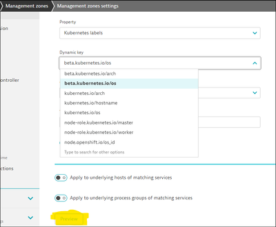

31 Jan 2024 04:12 PM
You can select your Kubernetes label:
As press "preview" button to see entities involved. It is to test if you rule is matching expected entities.
Best regards

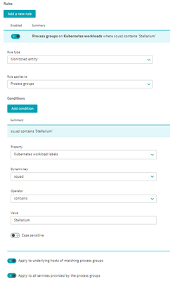

31 Jan 2024 02:45 PM
Isn't there a placeholder for the tag value to be the label?
31 Jan 2024 02:50 PM
Can I suggest using Monaco to create the management zones?
Once you have the proper template, you can easily create a new MZ using the template, with the squad name as a variable.
