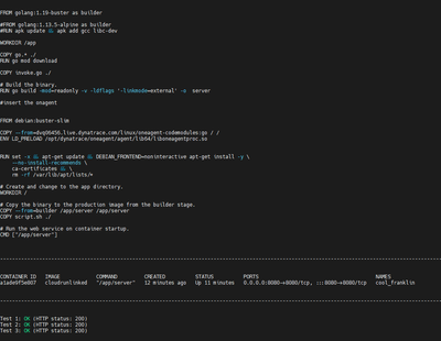

in a fresh Ubuntu 22 with docker installed.
I am trying to monitor this example in order to validate this documentation
But i am facing some problems. even after reboot the machine, restart the docker, delete the image. i was unable to achieve the monitoring of the image. i know that its monitoring the process but its not monitoring the services.

Do anyone have a valid working example of a api (with the services detected) build in Go that its working with dynatrace ? like in the demo,
i try some of us that we are using without success, i try this
https://github.com/crizstian/golang-api-example
https://github.com/wdrdres3qew5ts21/Example-Golang-REST-API-with-Docker
our last hope to monitor go image was the example 7 and is not working neither.
Logs: https://pastebin.com/fSbmFy1x

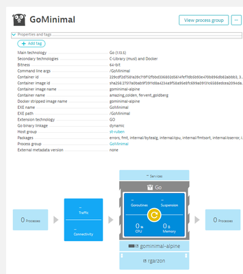

I would like to see this working as well. In my case I can't understand why oneagent-pass Go Agent gets Inactivated. We have disabled Go monitoring but we do enable it using dt_agent_type_overide='go=on'
