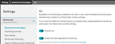

One Agent version: 1.29.x
We use Dynatrace Operator initContainer method prvision our pods with full stack. I can see that all the technolofy stack libraries (.so files) are present and LD_LIBRARY is also correctly set.
But Golang has been disabled (intentionally not selected) from Dynatrace monitoring because it might interfere with "other" things.
One example is istio sidecar proxy container that is running in the same pod. Say we don't want this container to be monitored but want our app containers (the names of which can be anything based on what teams want - and there are 1000s of them of them - some are Golang based).
Because of this Goland has been turned off but we would like to support that.
Is there any way to override the supported technologies via some annotation or something ?
Or
There is a limitation of what we can do in kubernetes environment and Dynatrace does not support this use case?

DT_AGENT_TYPE_OVERRIDE: go=on

02 Dec 2024 09:04 PM
@bhantol ,
If you're saying that GO is not being injected - then it is either
The way the GO App has been built is not compatible:
2. Built In Process Monitoring Rules (the legacy rule)
"https://{environmentid}.live.dynatrace.com/ui/settings/builtin:process.built-in-process-monitoring-rule"
There is really not much else to monitoring GO apps. It will do it by default unless disabled or it's not built in a way that Dynatrace can instrument (this will show a reason on process view or Deployment Status screen)
Thanks
02 Dec 2024 10:49 PM
The app is built dynamically. Checked with the 'file' utility.
Is there anything in the logs that look weird? I have pasted the link to that in another reply.
I mean if there was a problem injecting the logs should state what problem is there.
02 Dec 2024 10:57 PM
Also we upgraded DT agent to 1.303
Static analysis is disabled as per logs but app is dynamically built using standard go tool chain.

29 Nov 2024 06:37 PM
The technology type Go has been globally disabled.
Hence the DT override:-
DT_AGENT_TYPE_OVERIDE='go=on'
In that case again asking the question is the source codebase is available to understand or why the dynatrace UI does not show monitoring for this kubernetes workload.
The logs are unclear if the agent is working.
The dynatrace ui settings -> status does not show this working either.
