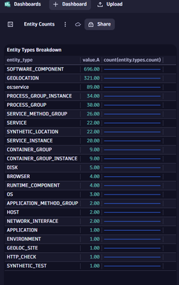

Examples of the data we can view once we have successful Workflow execution
