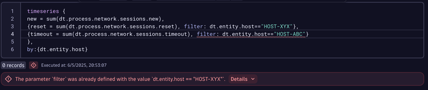

Look at below example:
        timeseries {
        new = sum(dt.process.network.sessions.new),
       {reset = sum(dt.process.network.sessions.reset), filter: dt.entity.host=="HOST-XYX"},
       {timeout = sum(dt.process.network.sessions.timeout), default:0}
       by:{dt.entity.host}
==> the filter gets places on new reset and timeout
In this example:
        timeseries {
       {timeout = sum(dt.process.network.sessions.timeout), filter: dt.entity.host=="HOST-ABC"}
       by:{dt.entity.host}
==> the filters are "and" so you get no results
So is DQL right or wrong?

Hi @henk_stobbe
This could be caused by the default union parameter value when combining multiple timeseries :
DQL Metric commands — Dynatrace Docs
Gerard

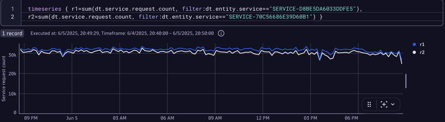

The correct syntax looks like this and every thing works even if there is no common subset between data for 2 timeseries. Please use filter: clause inside regular brackets (not curly).
re: second query. Syntax is incorrect. This query should not even execute:
Hello,
This is why I like the community so much (-;
As a remark, you really need to drop the BY:
An you can now use things like:
        | fieldsAdd x = arrayAvg(r1) - arrayAvg(r2)
        | fieldsKeep x
This is what my customer liked to see. Thanks!
KR Henk
one more addon, if you want to keep timeseries:
| fieldsAdd x = timeout[] + new[]
| fieldsKeep timeframe,interval,x
Have fun!
