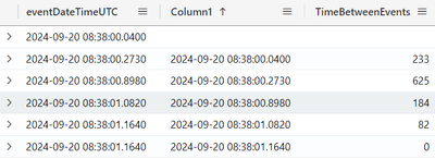

Hello,
I want to calculate the time difference the current record and previous record, until the end of the record.
example,
Thank you.

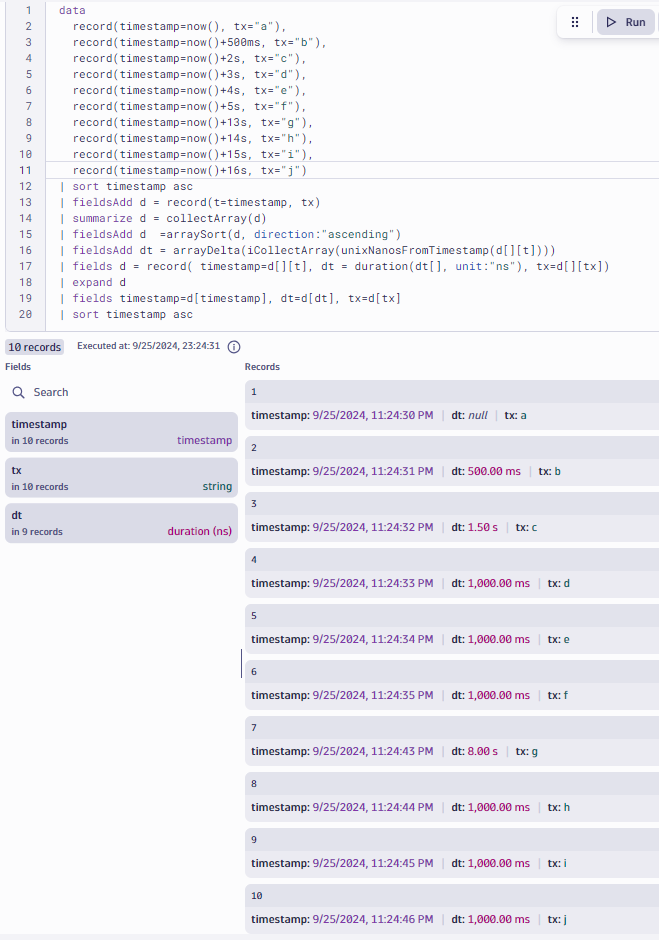

Window function are not available yet, but it is possible under certain limitations using collectArray , array sorting, and arrayDelta functions and your data set has well defined order:
data
  record(timestamp=now(), tx="a"),
  record(timestamp=now()+500ms, tx="b"),
  record(timestamp=now()+2s, tx="c"),
  record(timestamp=now()+3s, tx="d"),
  record(timestamp=now()+4s, tx="e"),
  record(timestamp=now()+5s, tx="f"),
  record(timestamp=now()+13s, tx="g"),
  record(timestamp=now()+14s, tx="h"),
  record(timestamp=now()+15s, tx="i"),
  record(timestamp=now()+16s, tx="j")
| sort timestamp asc
| fieldsAdd d = record(t=timestamp, tx)
| summarize d = collectArray(d)
| fieldsAdd d  =arraySort(d, direction:"ascending")
| fieldsAdd dt = arrayDelta(iCollectArray(unixNanosFromTimestamp(d[][t])))
| fields d = record( timestamp=d[][t], dt = duration(dt[], unit:"ns"), tx=d[][tx])
| expand d
| fields timestamp=d[timestamp], dt=d[dt], tx=d[tx]
| sort timestamp asc
Result looks like this:
max number of records processed using this method is 131072 according to documentation: https://docs.dynatrace.com/docs/platform/grail/dynatrace-query-language/functions/aggregation-functi...
