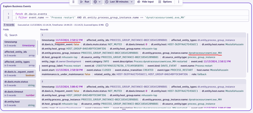

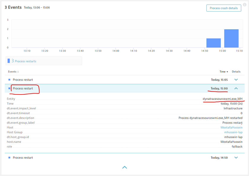

13 Nov 2024 11:20 AM - edited 13 Nov 2024 11:22 AM
Hi @AK,
yes you can, as you see in the following figures there's process restart events detected for process instance "dynatracesourcewmi.exe_MH". you can fetch it from dt.davis.events easily using the below DQL query
fetch dt.davis.events
| filter event.name == "Process restart" AND dt.entity.process_group_instance.name == "REPLACE_WITH_YOUR_PGI_NAME"
BR,
Mostafa Hussein.
