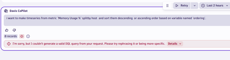

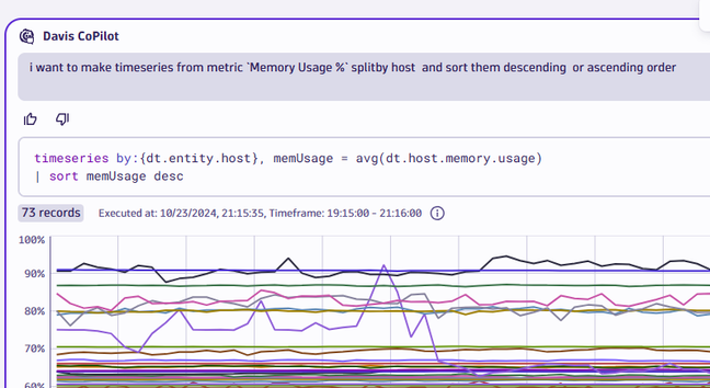

I've asked CoPilot to do this and as the following screenshot
it worked when removed this part of my question "based on variable named `ordering`" so it worked without setting ordering variable as the following screenshot
I'm considering this a good challenge that will help solving many tricks in the future if succeeded so I'm now digging deeper within it and will inform you once i get the desired result. mostly it can be doable when using DQL within javascript code as we can make 2 separate DQL queries , 1st one will get what's the ordering and the 2nd one will use it in separate execution.
