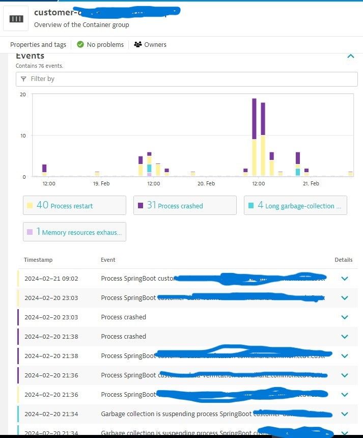

i need to create a dashboard for all container events in a specific container group.
i guess i need to use dql but i dont know how to do it.
lets assume container group name is mycontainergroup. do you have any suggestion?

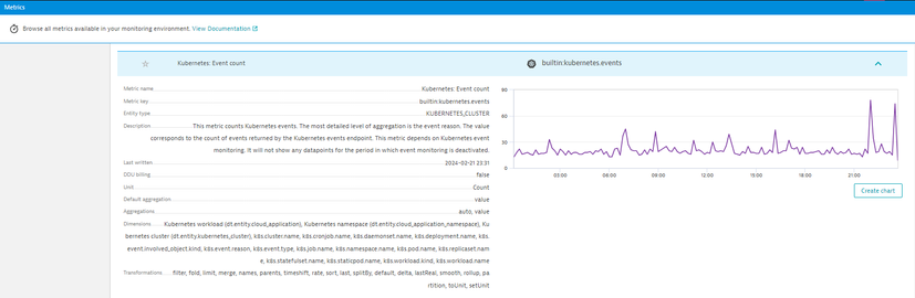

If this are events for k8 (pulled,killing, backoff... etc) then No need for DQL. There is a metric tha have that info if you have the events enable (i would asssume you do) metric : builtin:kubernetes.events
If you are speaking about events in the AI, for problem detection,  then there is this metric: dsfm:server.events.event_processing but you can't split or search for an specific entity.

hello. thanks for your help.
but i need those events you can see in visual:
You will need to use DQL for that.
fetch events
Is the base query you need and then filter by PG, what @dannemca said.

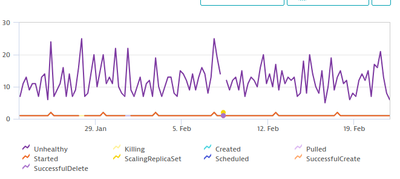

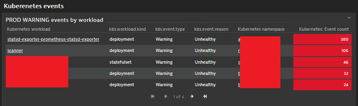

There is another option too if it is possible to use classic dashbboard with data explorer. If you have API integration to your k8s cluster you can use the builtin:kubernetes.events with many dimensions
You can create fancy dashboard tiles, like this:
I hope it helps.
