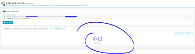

Hello, how is this great community doing? I have the following question: I have a chart created with bizevent, but I would like to have an alarm associated with the result of this. How can I do this?
Why haven't I been able to create this query as a metric to add it as "abnormal behavior"? Thank you very much in advance.
