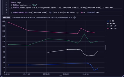

Hey Gib,
If I understand what you're looking for correctly I don't believe this would currently be possible with a timeseries as they have a minimum interval of 1m as mentioned here https://docs.dynatrace.com/docs/shortlink/metrics-limits#upgrading-to-grail. You can change the interval to be smaller but I don't believe that it would make a difference as they are stored with the 1m granularity.
If you were to query logs directly and then used the maketimeseries command you would be able to achieve smaller intervals as seen below.
