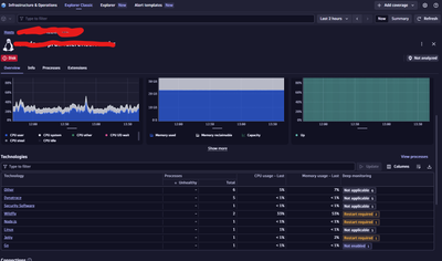

I recently started working intensively on FinOps in Dynatrace, and I've begun automating some processes.
I created a script to replace all Full-Stack hosts with Infrastructure Monitoring–only hosts. However, to determine which hosts can be converted, I currently need a manual validation from my team.
I'm wondering if I could retrieve some of this information through logs and/or the API, as that would help automate the process.
I'll send you a screenshot to see if you might be able to help.
In short, I need to obtain the **Deep Monitoring** information for each host.
