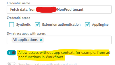

@Mohamed_Hamdy I have found out the root cause now. I have to enable the following options in credential vault entry to make it work:
