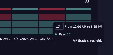

Hello,
I have the same issue using a workflow to trigger a Guardian (SRG).
As you can see my setup was set to use the timeframe 'today' (attachement SRG_timeframe.jpg).
But the result was always starting from 2:00am instead of 12:00am (attachement SRG_results.jpg).
> I could not found a workaround using the native Workflow SRG task.
> I had to add a pre-task using DQL to calculate the correct start time, here is the query (using my timezone) :
data
record(
start = toTimestamp(formatTimestamp(bin(now(), 24h) - (toTimestamp(formatTimestamp(bin(now(), 24h), timezone:"Europe/Paris")) - toTimestamp(formatTimestamp(bin(now(), 24h), timezone:"UTC"))), timezone:"UTC")),
end = toTimestamp(formatTimestamp(Now(), timezone:"Europe/Paris"))
)The start time is calculate with the substraction of the time difference between the 2 timezones.
I use that because we have to handle summer/winter time which cannot be handled by a static value given in the previous solution.
The endtime is not impacted.
Now the result is correct (attachement SRG_results_with_workaround.jpg).
I believe this should be corrected because
Hope this help future workflow users.
Florian
