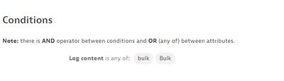

But as ingesting rule is defined to not capture content "bulk" but it is popping now it seems into logs
Could you please help me to rectify the condition?
Thanks

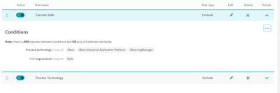

Is it as simple as the rule being defined as "Bulk" in the second Log content parameter but our actual log content is "bulk"?
I've tweaked that now -
But still appearing -
I am under the assumption your goal is to exclude the ingestation of any logs that have "This bulk request has failures failure in bulk execution:" in its log content. Assuming so, you will need to look into the Log Ingest Rules. There are some specifics around the wildcards accepted by Dynatrace, which I think the example from the documentation illustrates well:
If no wildcard is used in the value, then the matcher looks for an exact fit to the value. If a wildcard is used, the matcher looks for the exact match. For example, the value INFO results in sending only the log data having the exact INFO string, but the value *INFO* (using the wildcards) matches log data that contain the INFO string in its content.
Right now based off the screenshots, I suspect your log ingest rule is looking for log content that simply says "bulk" or "Bulk" as we aren't configured with a wildcard.
Alright thanks, changes are made now -
