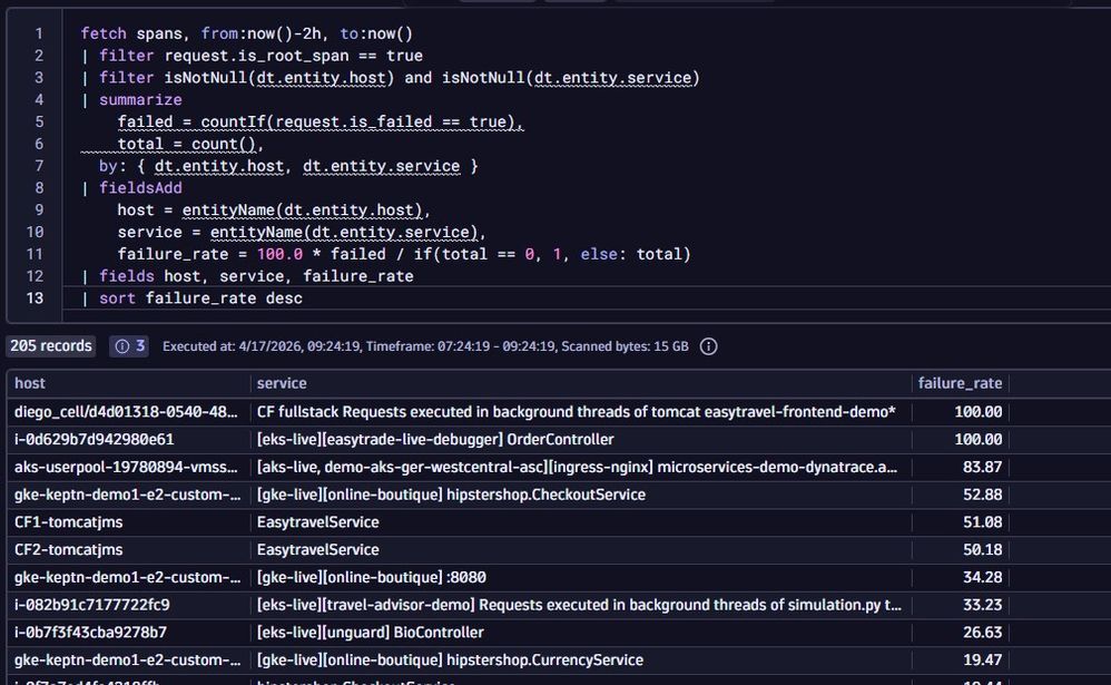

try this:
fetch spans, from:now()-2h, to:now()
| filter request.is_root_span == true
| filter isNotNull(dt.entity.host) and isNotNull(dt.entity.service)
| summarize
    failed = countIf(request.is_failed == true),
    total = count(),
  by: { dt.entity.host, dt.entity.service }
| fieldsAdd
    host = entityName(dt.entity.host),
    service = entityName(dt.entity.service),
    failure_rate = 100.0 * failed / if(total == 0, 1, else: total)
| fields host, service, failure_rate
| sort failure_rate desc
you should recive this:
