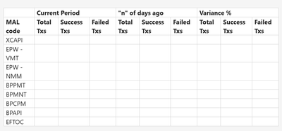

I'm building a comparative transaction dashboard that should display day for the current time frame but also data shifted by a number of days that will be a variable input.
The goal is to be able to show current data versus a comparison with what the numbers look like "N" days ago and then calculate the variance.
The structure of the table I am trying to create would look like this:
I have been able to create something close to what I need using the following:
fetch bizevents,from: now()@d - (toLong($TxCountNDaysAgo) * 1d), to:now()@d - ((toLong($TxCountNDaysAgo)-1) * 1d)
But if I select a time frame with a specific start time and end time, the shifted data will show the data for the full day, rather than just shifted by the number of days I have chosen.
