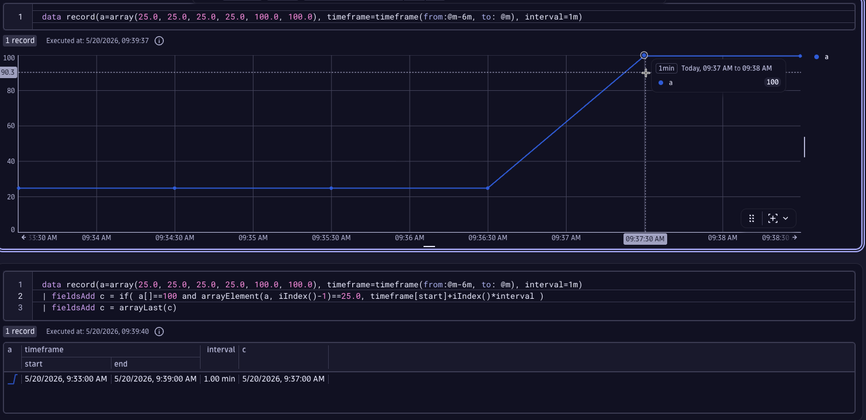

Of course you can run analysis of timeseries to track the changes. Right now with iterative expressions and arrayElement() function you can compare easily subsequent elements in array. Here is example DQL query getting last change from 25 to 100 in timeseries. Of course you can adjust the logic as you wish:
data record(a=array(25.0, 25.0, 25.0, 25.0, 100.0, 100.0), timeframe=timeframe(from:@m-6m, to: @m), interval=1m)
| fieldsAdd c = if( a[]==100 and arrayElement(a, iIndex()-1)==25.0, timeframe[start]+iIndex()*interval )
| fieldsAdd c = arrayLast(c)
