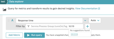

I have been trying to create a custom chart of some process groups. I want to graph the response time of them in one chart, i.e that each line of the graph represents a process group.
I tried manually tagging each of my process groups, but in the filter it doesn't appear like it. I don't know if I'm filtering wrongly or what I'm missing:
If you could help me, I'll really appreciate it..
Thank you very much!

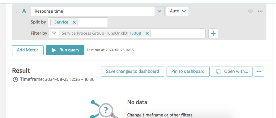

Hi Malaik,
I tried filtering by process ID like you recommended me, but it appears like the"Response Time" metric  only works for services. Is it correct? or is there a way I can graph that metric filtering by process?

Maybe you try Define your own process group metadata.
Or you can try to use another filter than tag, something as "Name" or another metadata.
