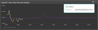

Hi @Romanenkov_Al3x, the timeframe selector doesn't allow you to set up a date/time in the future, as you likely already know.
However, you could use it like this example, where the date today is 6 March 2023: 2023-03-06 08:00 to now/m, which should give you today 08:00 to the latest timestamp, in my case today 23:20.
Granted, it won't completely satisfy your requirement to have two charts, each showing 08:00-21:00, with one for today and one for yesterday, but it is the closest you'll get to that in my opinion.

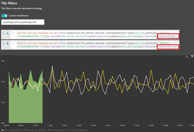

17 Apr 2023 10:02 AM - edited 17 Apr 2023 10:50 AM
Solution was to work with time-selector:
for work hours = yesterday+8h to yesterday+21h
and then for current time use timeshift - +1d - "now line"
for values that was - 7days ago - (-6d) - "week ago line"
without timeshift - yesterday "line"
@andre_vdveen big thanks for tips.
Now we need RFE for dotted lines 🙂
