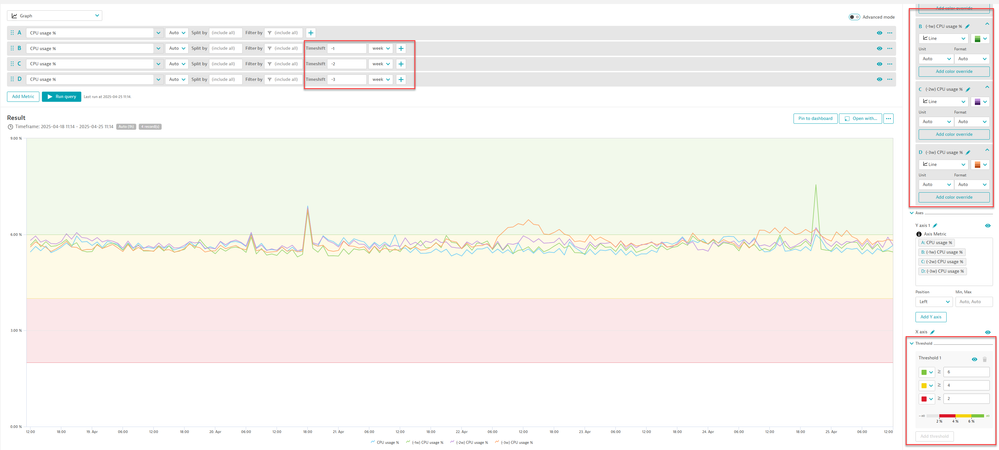

Assuming you are looking at classic dashboards, the following can be used as an overall method. In this example, I will be using CPU Max as the value Looking at 3 variations. 1 week ago, 2 weeks ago, and 3 weeks ago.
Granted that WONT get you vertical lines, but what you can do is overlay the metircs too. Starting at the last time frame. So post performance in 2 hours, then do a time shift saying -6 hours, then another timeshift with -8 hours.
You might be able to add vertical lines in the new dashboards/notebooks. But you could see about changing your view into something like a table view which will help bucket the time frames but they will become aggregate of what you have selected. You can rename the columns.
