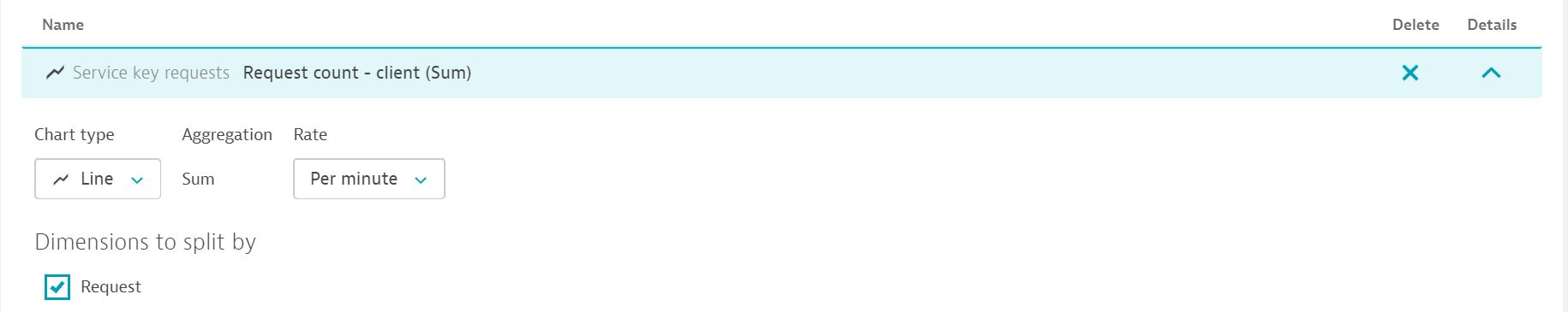

@Dallas P. Thank you for the response. So I have tried the 1st method where I am creating a customer chart and then Add metric -> Request count - client (Sum) as attached. I select the time range as 03:00 AM to 11: AM and export the result in CSV.
When i see the exported CSV, I see the time difference is 5 minutes and the count. So that count average number because it contains decimal? It seems the the longer the time range i select, the time range gets increased in the exported CSV. Please if you can confirm if this is expected?
Also, Request count - client (Sum) - Is this the correct metric I have selected?
Also I have no idea how to do that using metrics API. If you can advice, that would be hugely appreciated.
Hi Shashank,
Yes, the time interval change you see is expected. The larger the timeframe you are viewing the more time will be in each data point interval. The only way to get around this and to accurately plot every single minute would be to use the metrics api.
I would use "Request count" metric without " - client" at the end:
