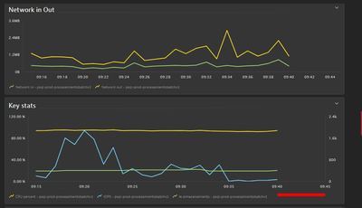

Currently, we are monitoring Azure resources. While we have metrics per minute, each update is being performed every 5 minutes. Where can I modify this so that the data presentation is not every 5 minutes and is more frequent?

I would exercise caution around changing the polling frequency as your Azure space grows you might run into these limitations: https://www.dynatrace.com/support/help/shortlink/limit-azure-api-calls#azure-throttling-limits
As per where to change it, I think that might reside at the Activegate level.
