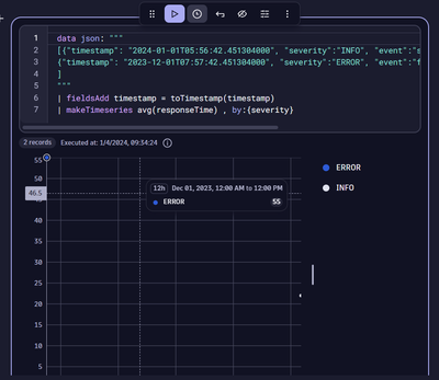

Hi @woodchuck ,
Spent some time looking at this and managed to get it wo work for myself few pitfalls that you may encounter but leads to the solution of the problem:
- Because this is JSON as input even though Dynatrace recognises all of these attributes as their own columns it does not recognise the data types so your timestamp is coming in as a string and not a date relavant data type to do this use:
| fieldsAdd timestamp = toTimestamp(timestamp)
- The other thing that tripped me up is that the date time was set in early 2023 and the default timeframe for a notebook that i was workong with is last 2 hours so its just something to look out for if you see no data.
I did manage to get it to work maybe adding more datapoints would make the chart a bit clearer but find the code here:
data json: """
[{"timestamp": "2024-01-01T05:56:42.451304000", "severity":"INFO", "event":"search successful", "responseTime": 22},
{"timestamp": "2023-12-01T07:57:42.451304000", "severity":"ERROR", "event":"failed to find product", "responseTime": 55}
| makeTimeseries avg(responseTime) , by:{severity}
And a Screenshot:
