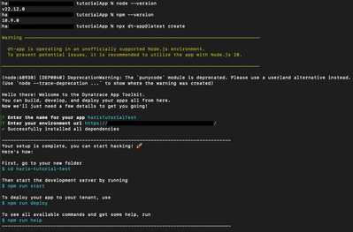

Hi Adrian, I've checked and couldn't find much here.
Can you paste a screenshot of the errors you see after entering the environment URL please? Also, I've tried replicating on my machine and I couldn't reproduce the errors.
