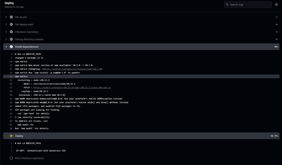

Hello colleagues, I'm having a problem deploying my Custom App via GitHub Actions.
The code is stuck in the authentication step, I'm using node.js v20 as indicated. If you can help me, I would really appreciate it!
That's the step.

I already have this permission, and I have already performed other Deploys manually via CLI, but I want to automate this using GitHub Actions, with .yml, but the code is waiting for authentication but it should be done through the Browser, and this is my problem, I would like to know how to solve this.

I assume you run the npm run deploy within the GitHub action.
To deploy you need to authenticate using an oauth Client and set the DT_APP_OAUTH_CLIENT_ID and DT_APP_OAUTH_CLIENT_SECRET environment variables.
