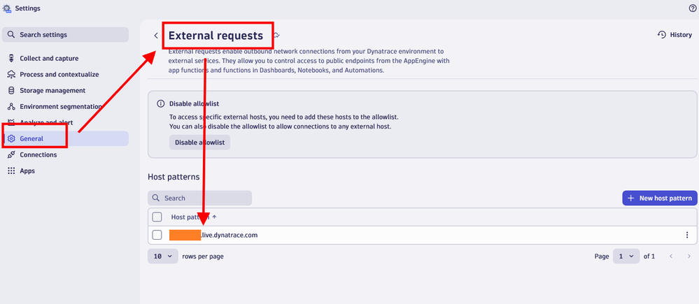

This was a tough one. I worked with @MaximilianoML on it, and a clue on what we had done before, got us through: we had to follow the procedure described in https://developer.dynatrace.com/develop/app-functions/allow-outbound-connections/ as the app was making API calls to the environment:
Please note that before it was available through Settings > Preferences > Limit outbound connections
Not sure why it disappeared from Settings Classic; trying to figure it out...
