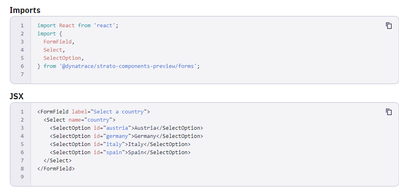

I'm trying to create a basic select using the documentation page available on the developer portal.
For example:

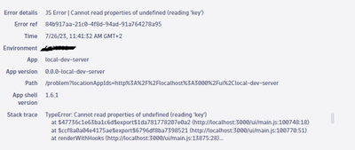

While executing this, the following error is shown:
Is also tried, without any success..
Does anybody also encountered this issue. If so: where is my error?

Hi @michiel_otten ,
this issue should be fixed in the latest version 0.99.3 of @dynatrace/strato-components-preview.
Are you already on this version? If not then please update your dependencies by executing npm run update.
