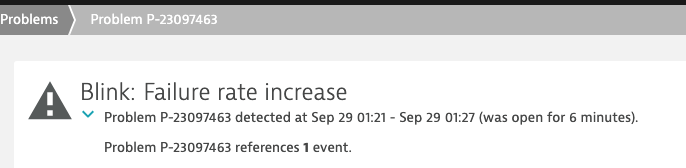

The startTime and EndTime are for the query and NOT for the actual Problem:
UI shows correct values:
How is this supposed to work? If I ask for a problem in the past?? Things like reports of problems in the last X days, to calculate total disruption based on entities and problems? like above?

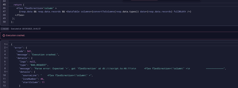

Thank for response. I used the example as a tuned down example I received as an example for problem inquiry.
I used your code as is in a new notebook and received the following:
Note sure why.. thanks in advance.
Went to the playground created new notebook and pasted your code in and ran code with same error

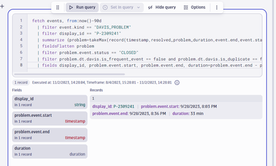

I did not know that you want to do this in notebooks. The code snippet I have shared with you works within a Dynatrace custom app
If you want to see the duration of a problem, you can use this dql query:
fetch events, from:now()-90d
  | filter event.kind == "DAVIS_PROBLEM"
  | filter display_id == "P-2309241"
  | summarize {problem=takeMax(record(timestamp,resolved_problem_duration,event.end,event.start,dt.davis.is_duplicate,event.status,maintenance.is_under_maintenance,dt.davis.is_frequent_event)) }, by:{display_id}
  | fieldsFlatten problem
  | filter problem.event.status == "CLOSED"
  | filter problem.dt.davis.is_frequent_event == false and problem.dt.davis.is_duplicate == false and problem.maintenance.is_under_maintenance == false
  | fields display_id, problem.event.start, problem.event.end, duration=problem.event.end - problem.event.start
Here you see the example problem.
for more examples on how to use DQL and Davis problems, please check out following help page: https://docs.dynatrace.com/docs/platform/davis-ai/davis-dql-examples
