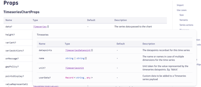

Looking at the documentation I see the following:
the Timeseries data has datapoints of type "TimeseriesDatapoint". However, looking at the timeseries interface I see the following:

30 Nov 2023 11:50 AM - edited 30 Nov 2023 11:53 AM
Weird, I see it fine in 0.109.0:
export interface Timeseries {
/** The datapoints recordset for this time series */
datapoints: TimeseriesDatapoint[];
/** The name or names in case of multiple dimensions for the time series */
name: string | string[];
/** Unit token for the value represented by the timeseries datapoints. Eg: 'kbit/s' */
unit?: TimeseriesUnit;
/** Custom data to be added to a Timeseries series payload */
userData?: Record<string, any>;
The only way I've found to reproduce this issue is by manually removing the TimeseriesDatapoint type in the Timeseries type definition. Is it possible this happened by mistake?
