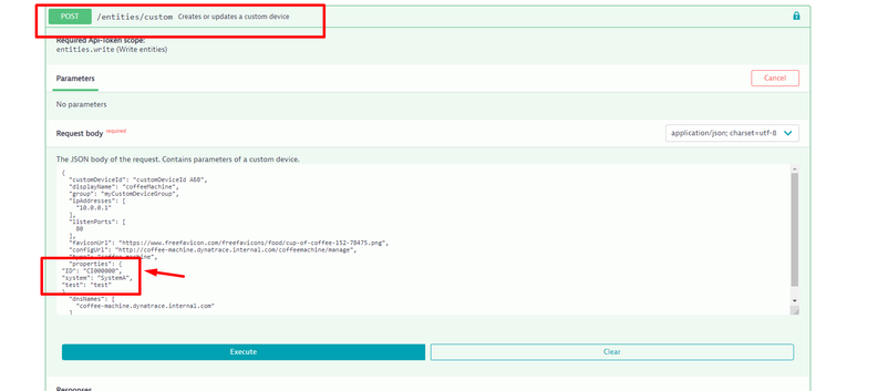

1. I created my  CUSTOM_DEVICE
 i used the required prorepties
  • ID -CI000000
  • system -SystemA
  • test - test

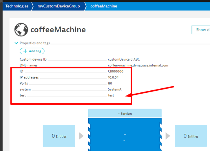

2. prorepties appeared in UI

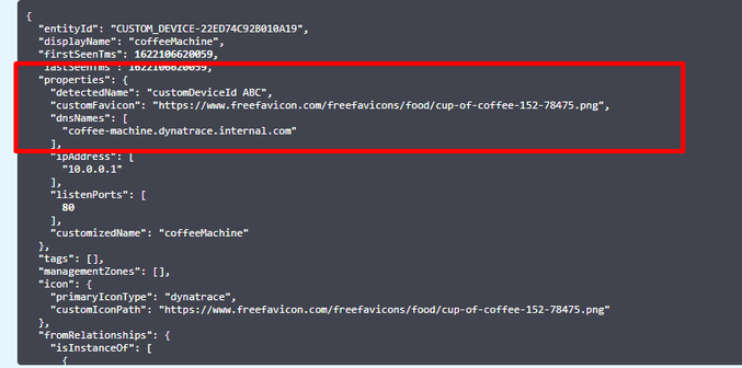

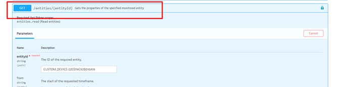

3.  I used api /entities/{entityId} to get information about my  CUSTOM_DEVICE
4. the result did not show my property

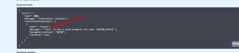

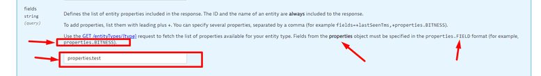

5. I used the flag "field" according to the doc
the result gave an error (although the UI shows that I have a property "test")
