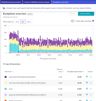

You may be looking for this information displayed in the multidimensional analysis tool
There you can create a Metric based on the Exceptions and the count.
Once you have the metric you can easily pull the information from /api/v2/metrics
You may need to filter down the search using a specific service or request otherwise it may not work if you have too much data in your environment.
Please note that creating additional metrics consumes the DDU licence.
