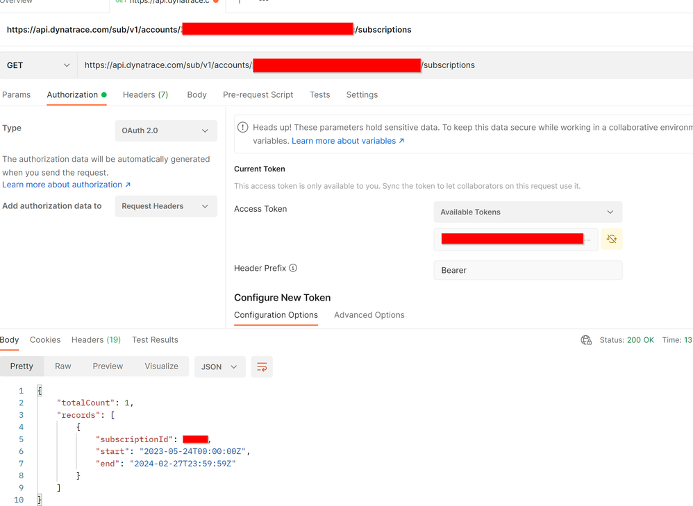

I tested an account in postman and got this result:
Have you input your bearer token for Authorization?
